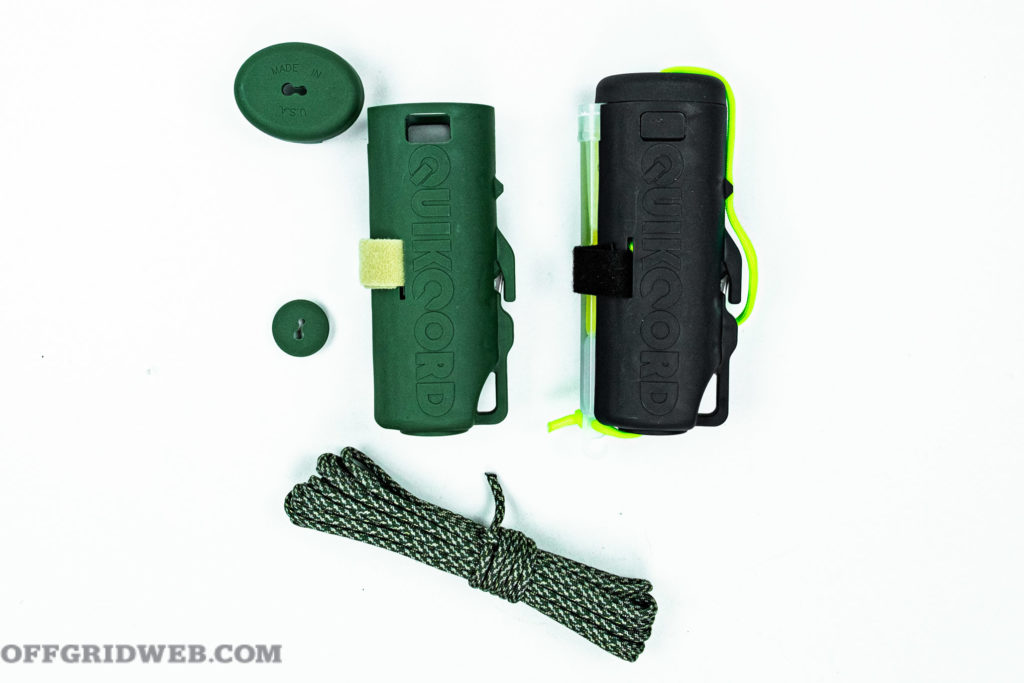

  • QUIKCORD 550 Cord EDCQUIKCORD 550 Cord EDCThere you are, in the team room with the unit. As the new guy, you stand, while others sit. You wait for your team leader to give you instructions. Keeping to yourself, you read your […]
