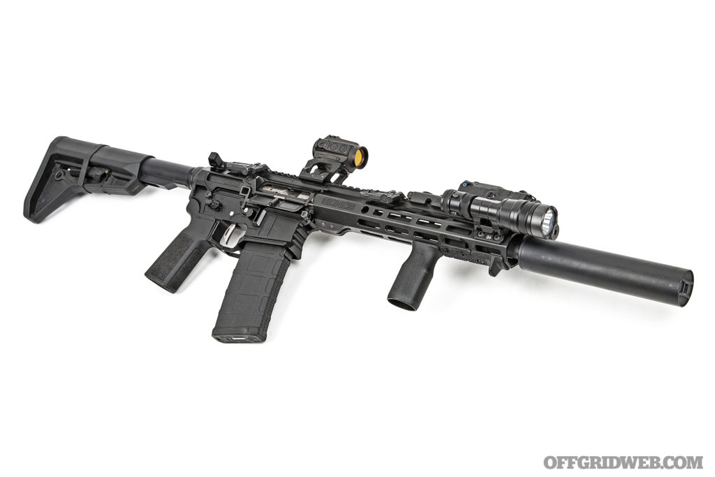

For my second rifle, I decided to achieve the legally required barrel length so I didn’t have to register it as an SBR, therefore avoiding the $200 tax stamp and interstate travel restrictions associated with SBRs. Rather than buying a 16-inch barrel and ending up with more length and weight than I wanted, I started with a Criterion CORE Series 13.9-inch barrel. This barrel came with some optional add-ons: a headspaced Bravo Company MFG (BCM) bolt carrier group, a Badger Ordnance gas block, and a gas tube. My local gunsmith — Wright Armory in Mesa, Arizona — permanently attached a SureFire Warcomp muzzle device to the barrel, extending it to meet the 16-inch minimum. This is usually referred to as a “pin and weld” setup, because that’s exactly how it’s affixed.
The barrel is installed in an American Defense Manufacturing ADM4 billet aluminum receiver set. Like the receiver I used for my 11.5 build, the ADM4 has an enlarged, ambidextrous bolt catch and release, but it also adds an ambidextrous magazine release and a forward assist. Although it has extra controls that differ from Mil-spec, the standard controls won’t feel unfamiliar to anyone who has run an AR before.
Above: The ADM4 receiver’s large bolt release paddle is impossible to miss, and it’s paired with a lever on the opposite side of the receiver that offers the same functions to the shooter’s index finger. The mag release is also ambidextrous.
A Midwest Industries Night Fighter 13.5-inch handguard is designed to reduce handguard flex, which will be useful if I add an IR laser for night vision use in the future. That rigidity is also useful for stabilizing the weight of the rifle via a bipod; I attached a Harris bipod to the handguard using a Midwest Industries M-LOK bipod adapter. Although the SureFire Warcomp can serve as an attachment point for a suppressor, there’s not enough clearance between it and the end of the handguard; if I decide to add a suppressor to this build someday, I can install a shorter Midwest Industries handguard for more clearance.
The lower receiver was completed with one last part from Midwest Industries, an Enhanced flat-face drop-in trigger. It provides a clean 3.5-pound break and well-defined reset that are suitable for precision shooting, but it’s also capable of quick shots at closer range. Like the 11.5, this build also features a Radian Talon 45-degree safety selector and a Radian Raptor charging handle.
