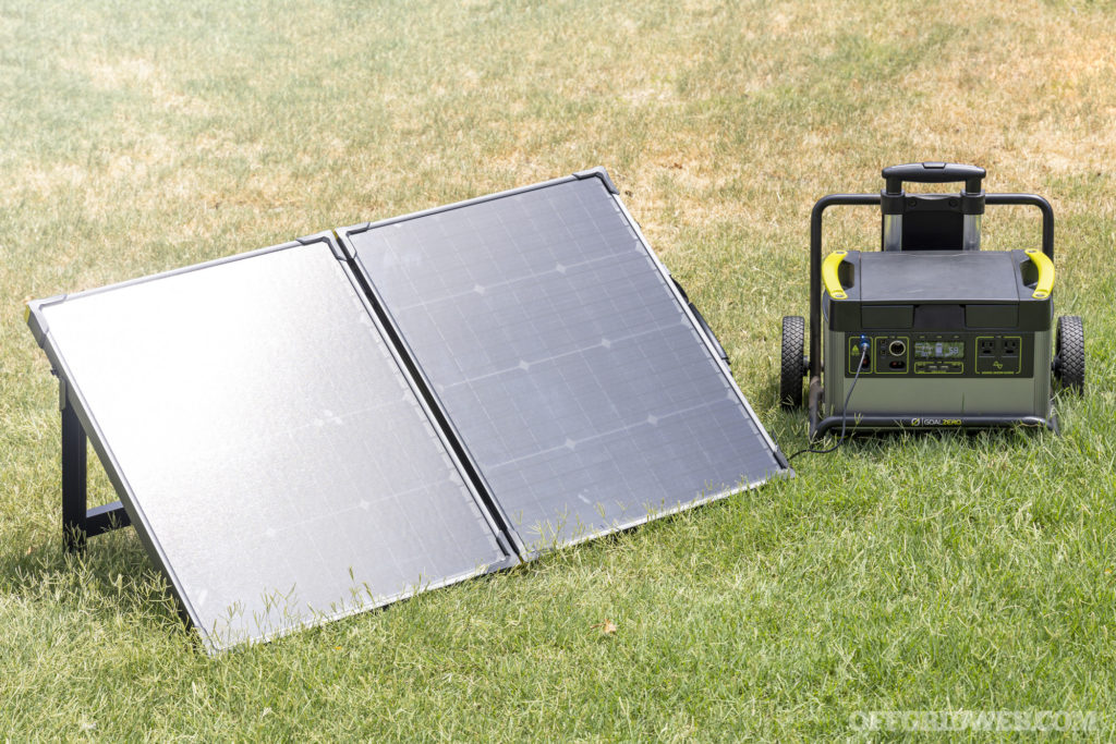

Above: In long-term off-grid settings, a solar panel can be used to recharge the Goal Zero Yeti during the daytime.
