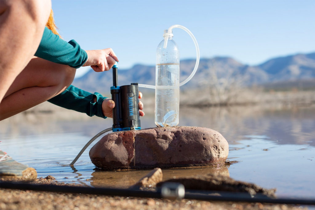

Water collection and purification requires flow from the source to the clean water container. Hand pumps and filter bottles can be effective for smaller amounts of water, but producing large amounts is tedious and labor-intensive. Gravity filters are another option, but they’re painfully slow and sensitive to clogged filters.
