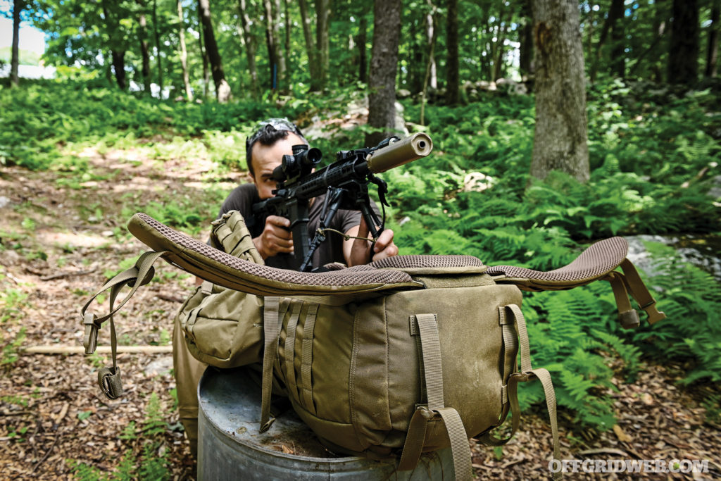

Above: With the brace compressed and the JK Armament suppressor removed, this EPC-9 can fit into a small backpack with ease.
